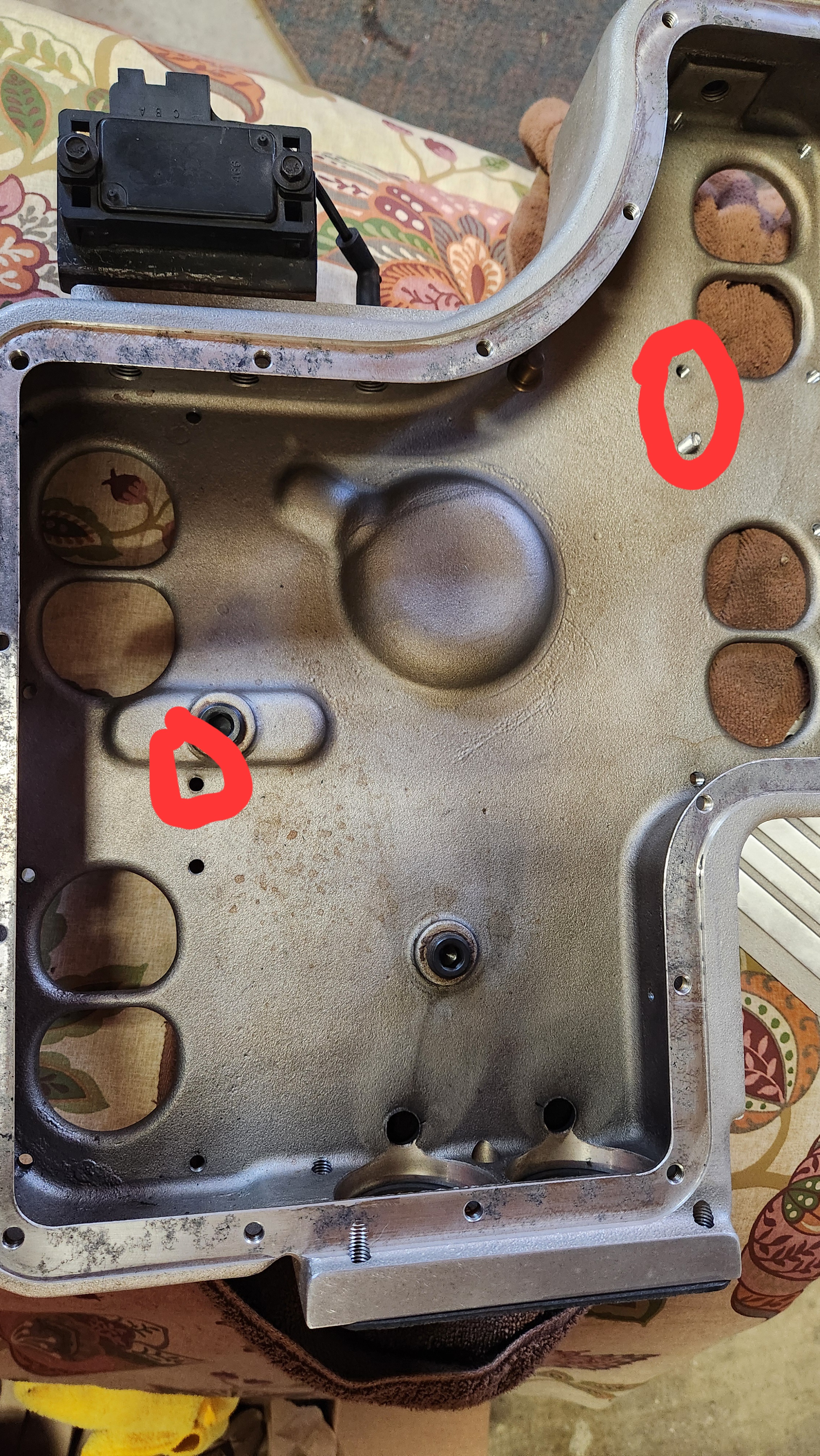

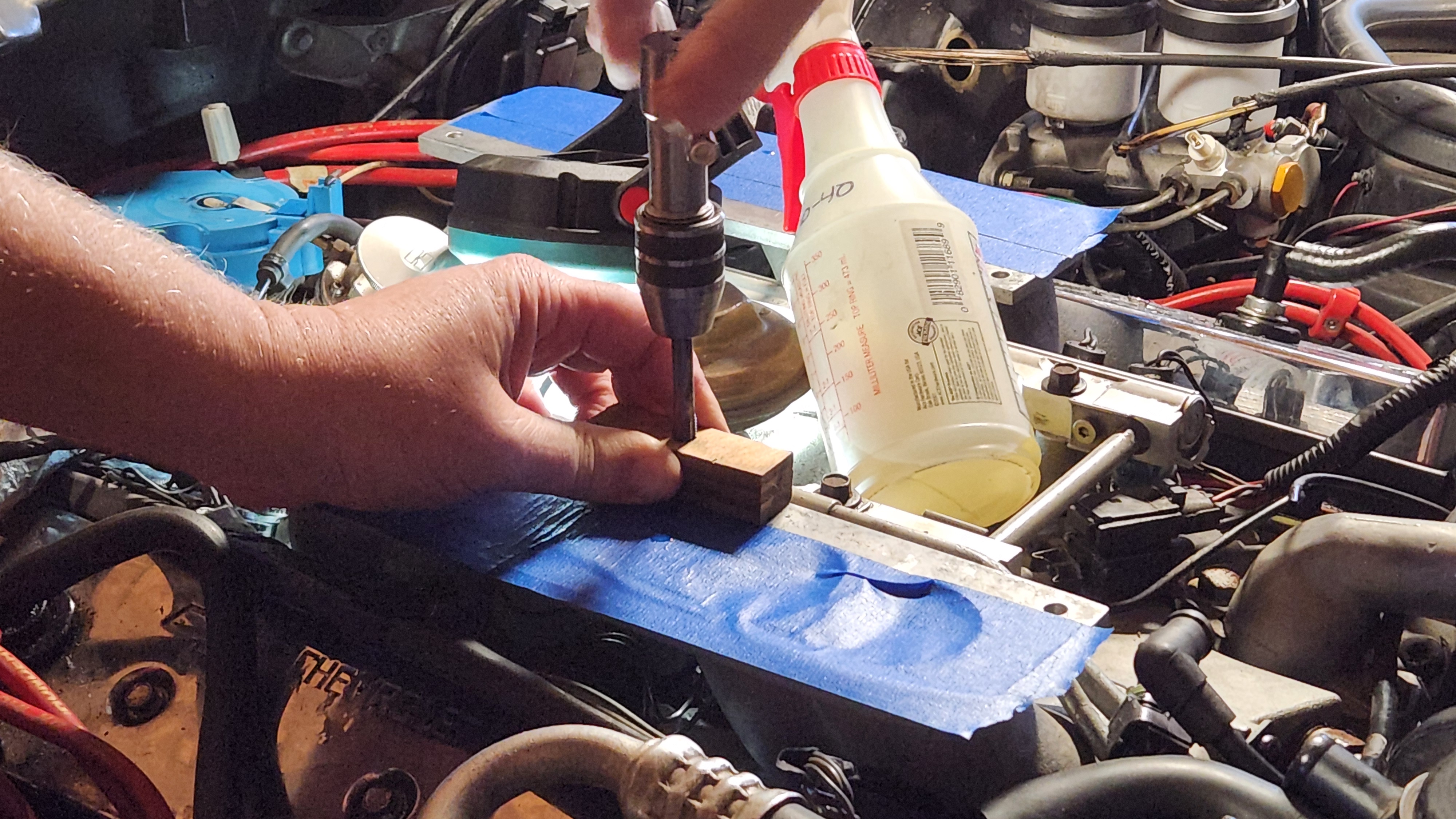

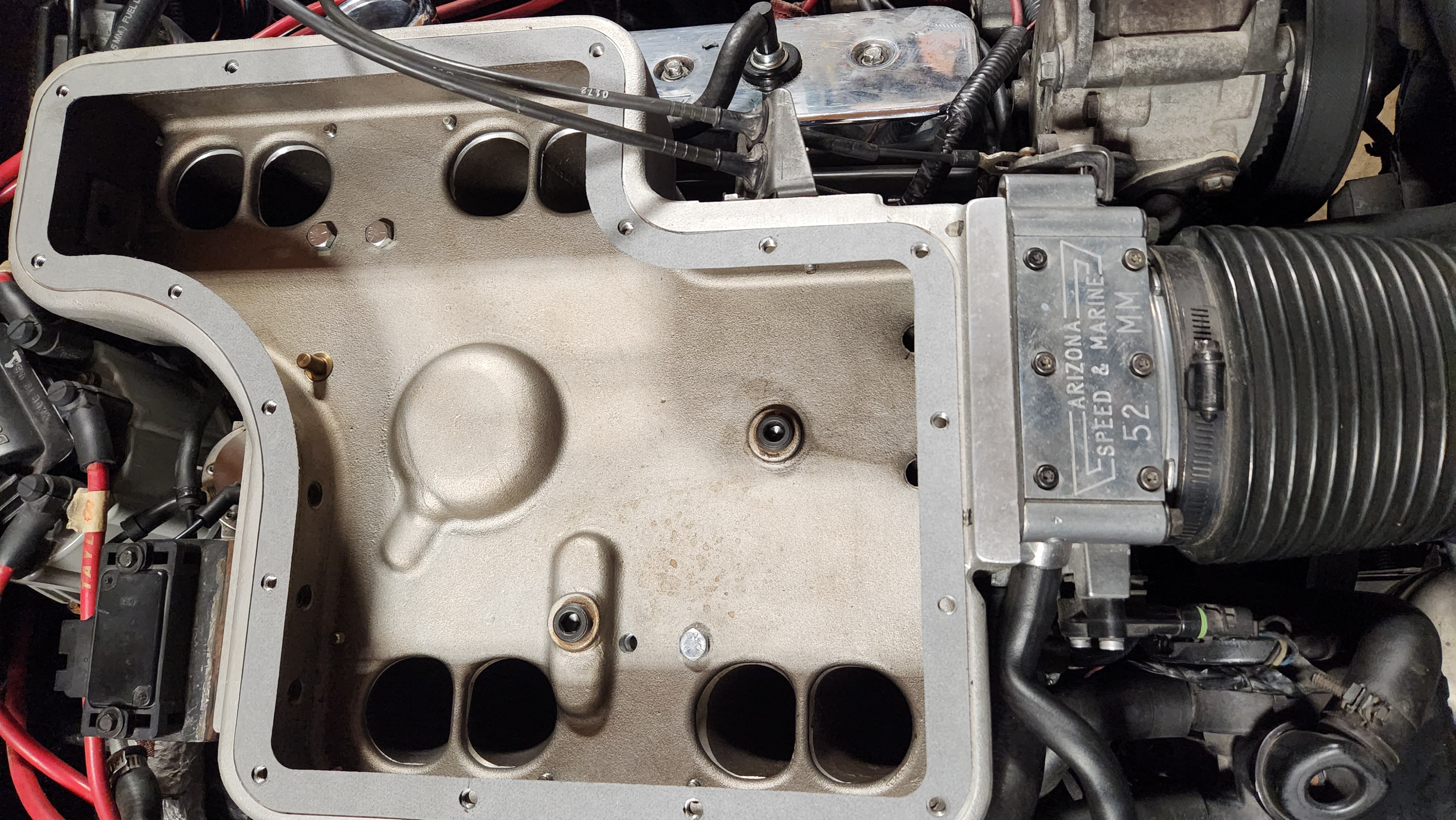

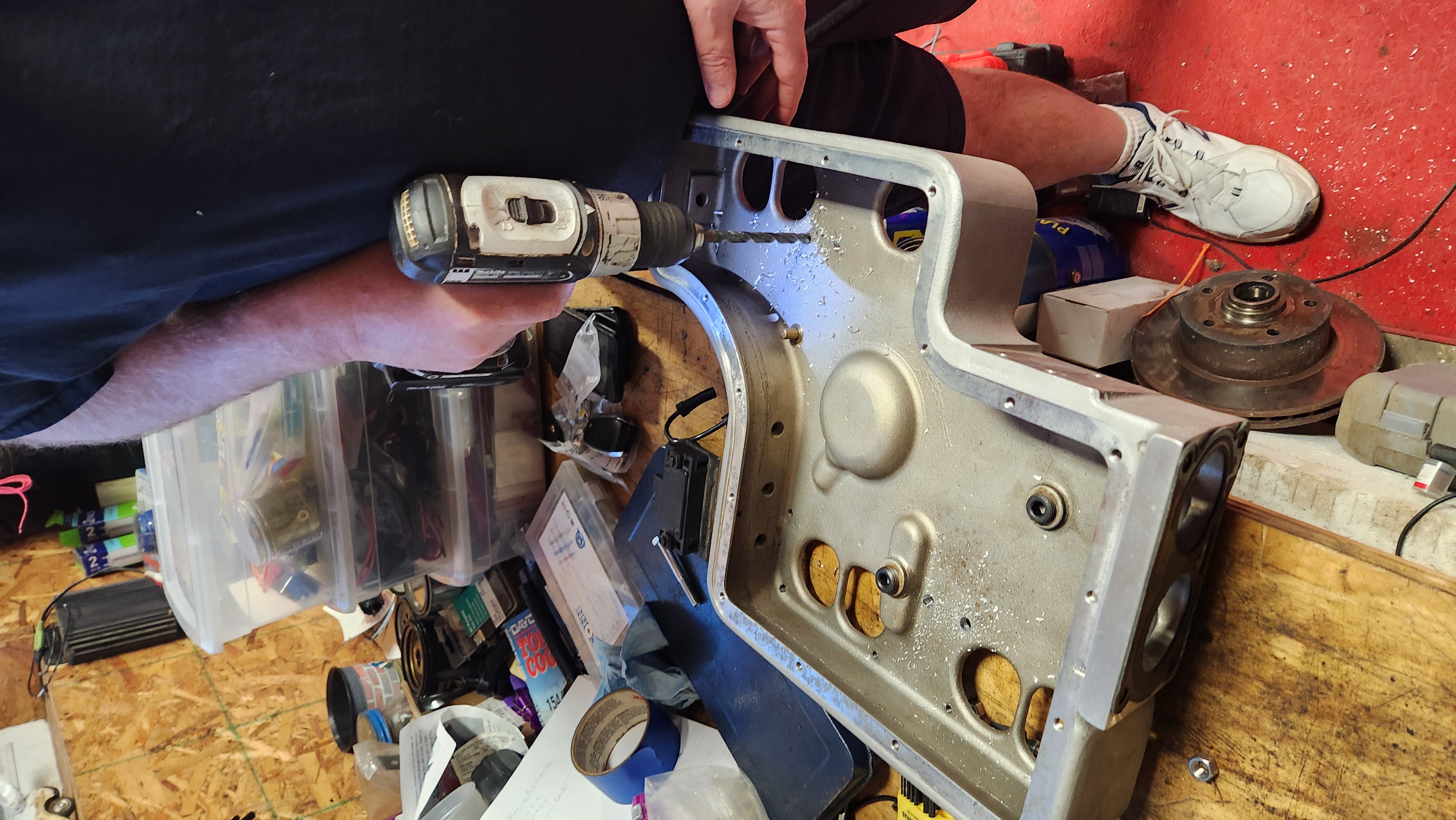

I ended up tapping the runners and drilling the plenum and it turned out being way easier than I thought. The holes didnt need to be drilled out any bigger. I used a 5/16-24 tap. Dave Speece came over and gave me a little trick for getting the tap started squarely. He took a little piece of wood and drilled a 5/16 hole on my drill press. We ran the tap through the wood, which took a little effort. Then just leave a little tip protruding on the bottom, hold the wood against the surface and tap away. It probably took 5 minutes to do all of them. After that, we drilled out the four holes in the plenum to 21/64. I need to get some button head fasteners. The casting hump is too close. With 3 of the 4 bolts in place, we put the lid to see if it would start. Sure enough, it started right up, although that open hole provides a good vacuum leak. The good news is it sounded good!

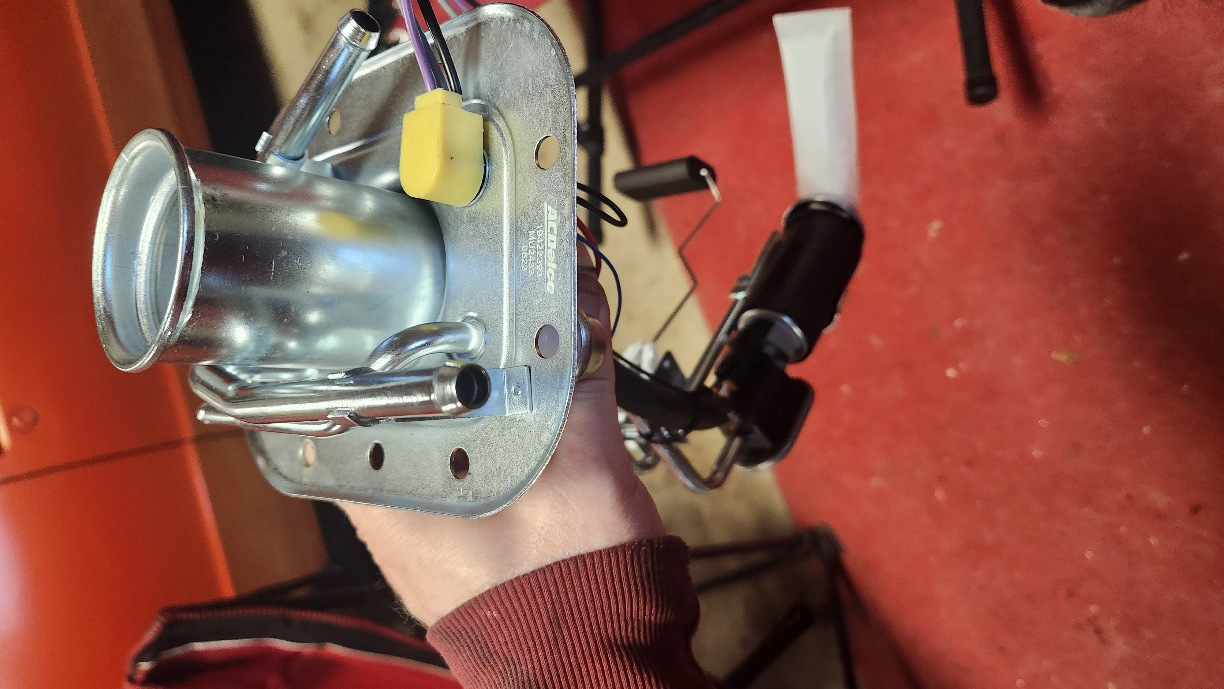

I eyeballed the fuel filter when it was up in the air last night and it looked relatively shiny/new-ish, but found no reference to it in this thread, so I guess I've never changed it. I'll order a new fuel filter. I also ordered a fuel pressure test kit. I think you guys have said a fuel pump is a pretty easy job on this car.

*) installed new fuel pump, fuel sending unit, and fuel filter. The good news is, the car starts and runs. The bad news is I'm not seeing anything on my gas gauge. The other bad news is that I had trouble with the gas pump at Sunoco clicking off with anything but the absolute slowest pace. what the heck?? It was a struggle to get one gallon in. But at this point, the entire fuel system has been refreshed from pump to filter to injectors. And the worst news is the the problem STILL persists.

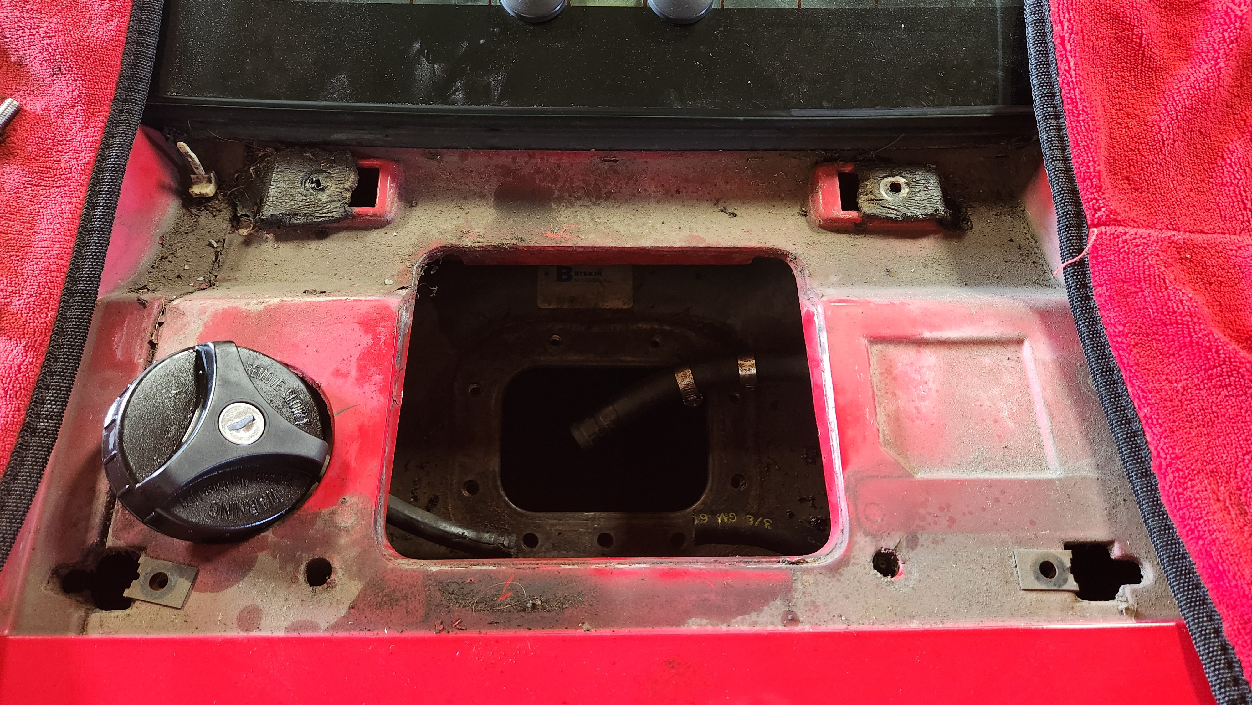

When Fred visited Raleigh last June, we worked on a blown piece of hose coming off the fuel pump.installed new fuel pump, fuel sending unit, and fuel filter. The good news is, the car starts and runs. The bad news is I'm not seeing anything on my gas gauge.
When we pulled out the fuel sending unit assembly we also saw the reason for the fuel gauge malfunction. The float arm was missing!! Obviously it was floating somewhere in the tank, but we couldn't see it. So I took a long piece of coat hanger wire and went fishing. As I did this, the float came floating by the access hole as I disturbed the gas in the tank. We fished it out and saw that it had just come undone from the fuel sending unit. It just clips in like carb linkage. To prevent this from happening again, Fred suggest using a very thin zip tie to fasten it more securely. This worked great.

Good news -- I drove the car to Chardon over lunch and put 17 gallons without any issue and the gas gauge was showing full. Maybe it was just that first gas pump at Sunoco that was bad. I'm calling the fuel system done. Sending unit/pump/filter/injectors professionally cleaned.The bad news is I'm not seeing anything on my gas gauge. The other bad news is that I had trouble with the gas pump at Sunoco clicking off with anything but the absolute slowest pace. what the heck??
